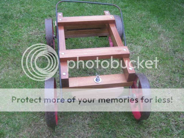

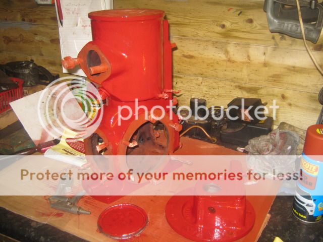

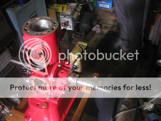

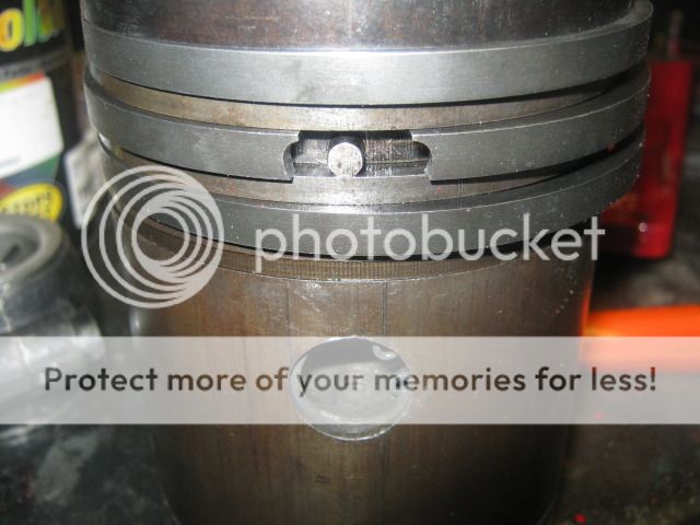

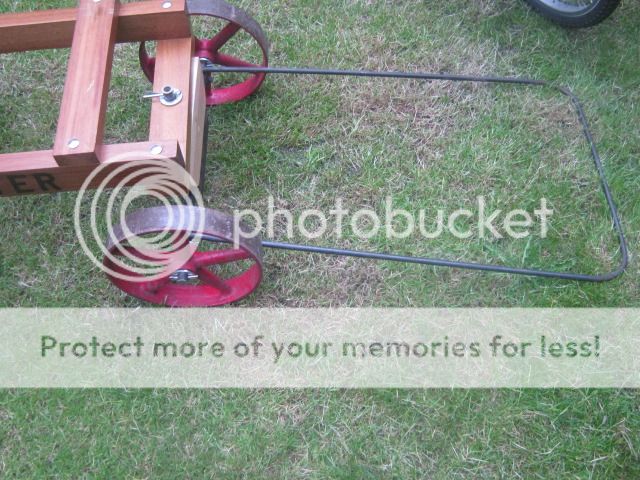

well as some of you already know i had a few probs with the petter i bought, well that was back in march, finally some progress has been made and fingers crossed im on the way to getting it done ive now got the block back after having a liner fitted new rings and a gudgeon pin made, also ive nearly finished a trolley for it as well, heres a few pics of the progress
New liner fitted and bored

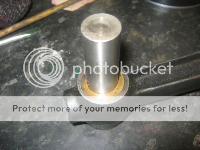

new gudgeon pin made
new gudgeon pin now held in with circlips instead of the bolt where it sheared off before

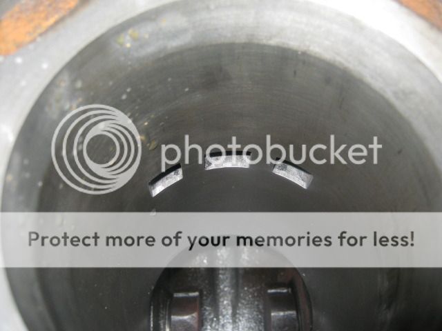

new rings fitted gapped and cutouts for the stops

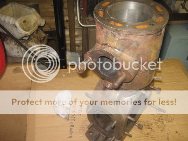

block stripped ready to be prepped and primed

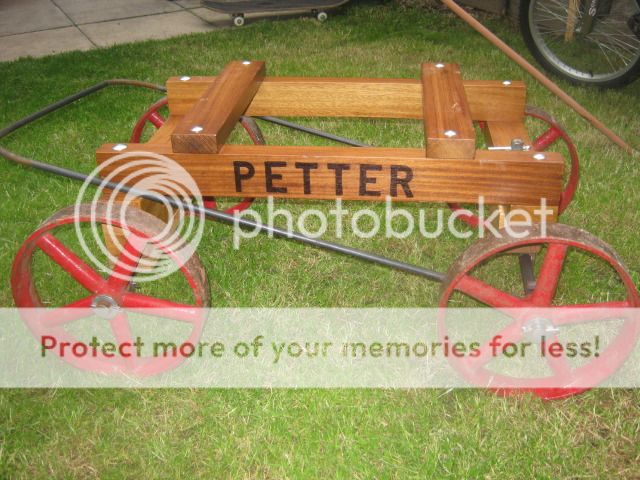

trolley progress
and finally bits ive already painted
trolley progress

Glad the piston and small end has been sorted mate ... looks a cracking job .
I do like the trolley that you have made , nice work ... keep it up

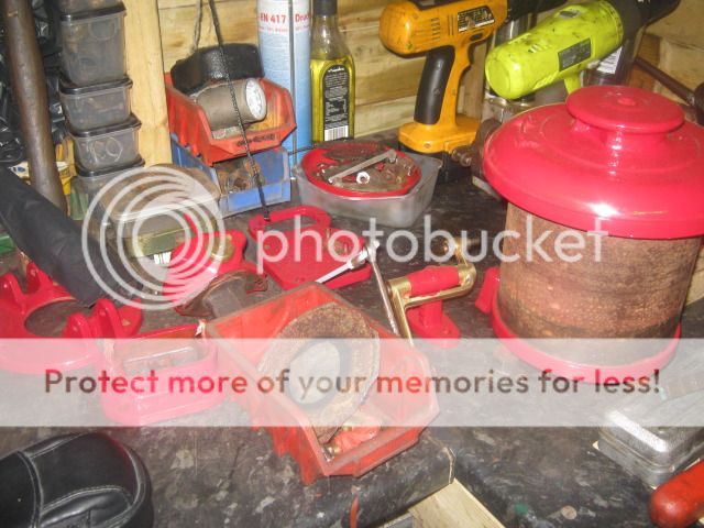

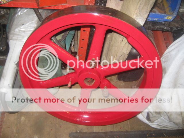

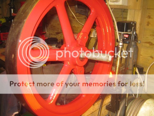

Once again thanks all for the comments, a little bit more progress today was achieved hopefully will get trolley finished tomorrow so i can start the rebuild later this week as i will be building it up on the trolley,
final coat on the last of the flywheels,
first coat on the block will leave to harden while working on the trolley now for a cpl of days then flat down and second coat, by then trolley should be all ready to start building up the engine,

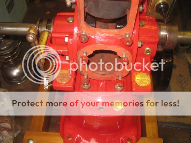

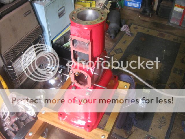

A bit more progress over the last cpl of days, its taking its time as ive never had so many interuptions as ive had this week so far,
a few more pics and not long to go one hopes,

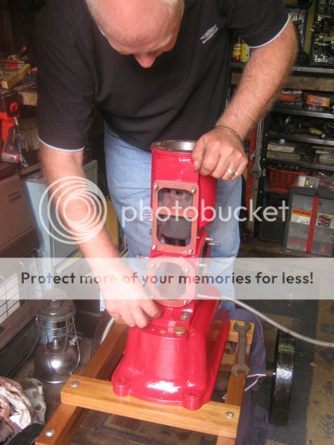

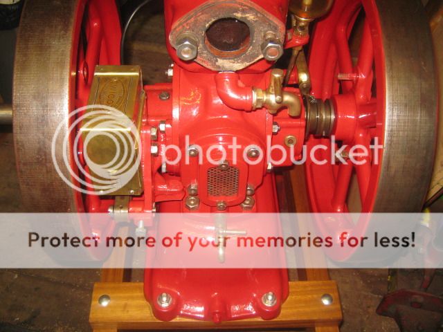

the block on the trolley now for rebuild
the Doctor caught working lol
mag fitted easier to fit now than when flywheels on and bolts on with main bearing housings
before its said no the nuts havent been left like they are in the pic they have all been cleaned up

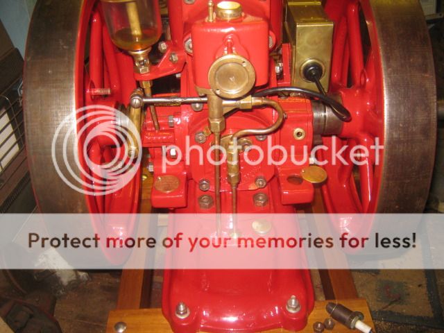

a few more items fitted working my way up from the bottom
and thats all for now hopefully tomorrow or thurs well know the good or bad news lol

Good to see you making progress, the block does look small compaired how big the engine is when finished. I thought you'd be wearing a white coat Dr when working on your engine

Looking good big feller, the only reason the block looks so small is its been photoed next to you lol
