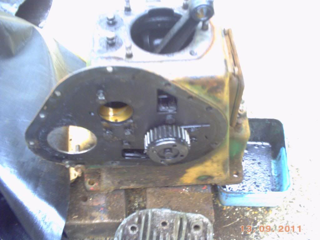

Have had a look at bottom end which seems ok , bore not too bad just needs de glazing think im going to end up doing a full stripdown although i may put it back together and run as is for now obviously with a bit of a clean up until later in the year

As long as it's not to much end float you should be ok, most engines have a bit of play and run no problem although one of my engines did and it ended up leaking oil so that could be something to watch in the furure with yours, mine I just wipe off the oil for now LOL.
Re: Petter A11
Yeah, plenty of these old engines develop end float in old age. I've had some which have been quite considerable, but they still ran OK.
Was this end float after you started taking it to bits? Sometimes it disappears when it's all back together.

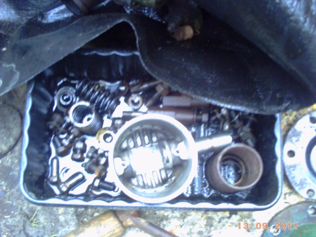

As can be seen have done some work on the engine more stripped down some cleanup underway , the valve seats and area around were in a bad way but have made a start on cleaning and regrinding sorry i need a new camera
piston mostly cleaned think engine may have overheated at some time as the oil has been badly burnt on but cleans up ok with a bit of effort
oh and whats this i found glad i stripped it now ( in case you cant tell its a small ball bearing)
by the looks of some damage i have found looks as if at some time something has been through the cylinder markings on head and mark down the side of piston luckily nothing that cannot be rectified

The ball bearing will most likely be from the magneto governor pushrod, they are often missing as they can drop out when the mag is removed.

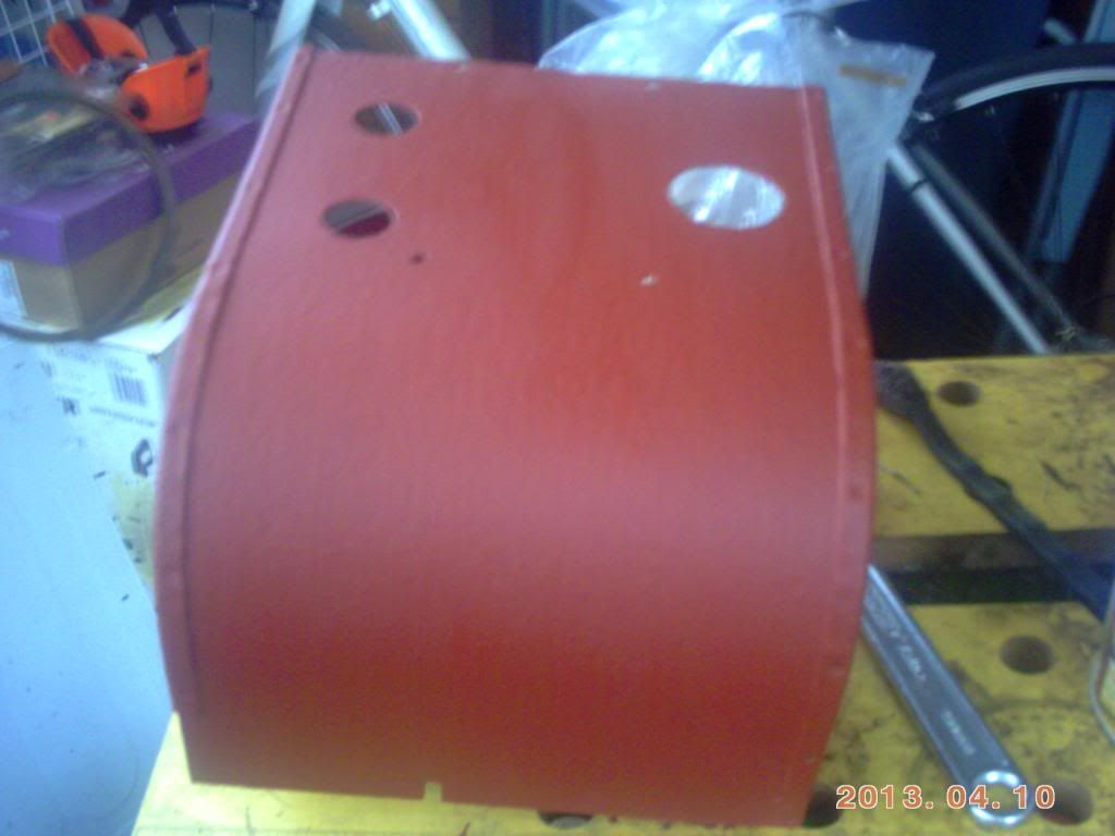

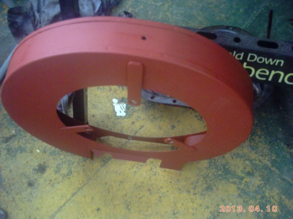

Engine etc all rubbed down and started on undercoating will be trying to smooth out some of the areas that have suffered severe pitting

For smoothing out pits and other imperfections Cellulose Knifing Filler/Fine Suface Filler as used on car bodywork is the stuff.
Just done the chain guard on the D I am restoring which was badly pitted, go over with that, rub down, blow a light coat of paint on, see where the imperfections are and repeat until you are happy.

Funny thing was areas were completely clean when i took the dirt of paint came away with dirt no rust completely bare clean metal other places were more what you would expect of an engine this age ( dated to 29/04/1947 ) can only assume that some of the ingredients in the dirt ( which was fairly moist and sticky ) had preserved some areas rather well .

I usually brush on a couple of thick layers of red-oxide primer, sand it right back, then repeat if necessary, to fill in pits. The thing is, at the end of the day, it's not going to be seen that close up, & a few rust pits are to be expected.
If you're spraying though you need to use that fine filler, as it would probably take you ages to fill in pits with thin spray coats.
My magneto which came with the Kohler was quite badly pitted, I think it took 3 coats of red oxide, rubbing right back between coats, & it looked pretty good. I didn't get rid of all the imperfections, but how far do you want to go?

Been doing a few bits on engines everything is pretty much ready for re-assembly have a few gaskets to sort out most of the pitting has filled in ok once i get topcoat on dont think it will be visible mechanically cant see much wrong only damage that may affect running of engine is the main bearing but i think it will be ok oh and the cork on tap has had it
as you can see i got wet good job undercoat was dry and there are some non petter parts there engine and tank mount for this
wth thats over shinny
