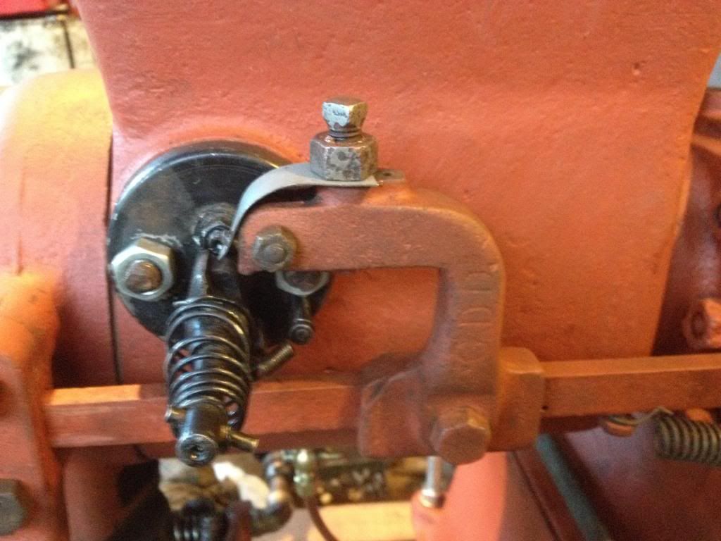

Hi all, As some of you may know i'm re-building My 3-1/2hp Amanco, at the moment i'm trying to get my head round the operation of the ignitor set up and how it operates! from looking at other pictures it seem that mine is missing a picker spring, does anybody know where i can get one ? it had a sort of adjustment screw apparatus fitted when i got it , what i can't work out is what the pricker spring does ie hold the pricker head down or lift it up and over the ignitor!Here's a couple of pictures of it.
Thanks in advance, Karl.

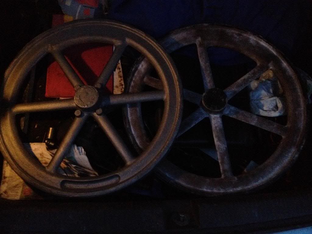

Yes Lewis its being heavily re-built including a brand new flywheel , i'll look for the spring, do you have a link number ?

Lewis MacRae wrote:Sorry no I don't, don't even know if they are still  on as it was a few days ago I saw them although there is a whole ignitor on there. You have me intrigued, how are you making a new flywheel or is it of a doner engine?
Easy its a copy-cast job, I just built up the outside rim and center boss with tape to allow for the shrinkage !
The new one is on the left,its currently waiting for me to find time to machine it!

Yes that's her, anyway we disrespect from my original question, what does the pricier spring actually do?

EarlBathurst wrote:Yes that's her, anyway we disrespect from my original question, what does the pricier spring actually do?
Keeps the tension on the picker , the bolt on top is fine adjustment for trip timing and lock down with locknut . If you look at my choreboy topic it will all become clear . ( chore boy topic under this one in same section)

Post by EarlBathurst on Thu Dec 05 2013, 20:33
Some progress today, Finally worked out how the pricker operates, i have made a temporary spring the thing seems to do the job when turning over by hand.
also i've made all the fuel pipes from the tank to the carb, made and fitted the tank stand/box.
