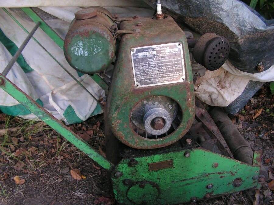

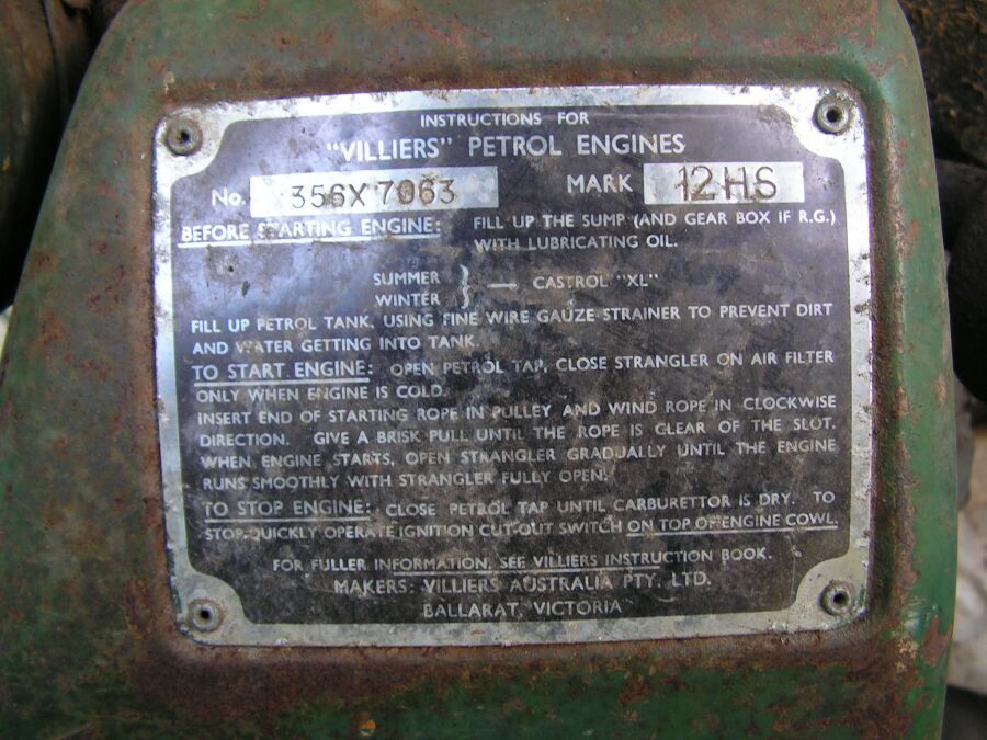

I spotted these at a scrap dealer, these motors were headed for China and the melt down furnace One of them is a 12/2 whatever that is ?

Hi,
The HS denotes High Speed - 1.95b.h.p at 3,400 rpm.
From Villiers brochure:
"In most respects there engines are similar to their counterparts but certain changes are made to the carburetters, air cleaners and governor settings. An oil bath air filter is fitted as standard on all H.S. Models"
Hope that helps.
I have the "Villiers MK10 and 12 Operators Manual and Spares List July 1957" if you need one.
Hope that helps.

The mower was running when I purchased it for 15 bucks , but I think the magneto has died , the spark has disappeared
My other engine is a WW2 Canadian made chorehorse . A 12v wireless battery charger engine made by Canadian outboard & Marine . It is basically a Johnson pre war engine . I bought this motor new in the box years ago , with its can of oil and tools and spares , unused . I believe BSA made a post war copy of this engine in the UK .
One of the three in the middle pic is a UK made engine . Can anyone spot it ?
