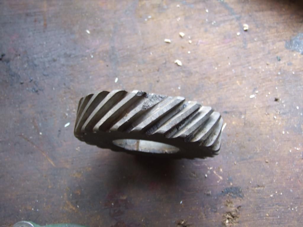

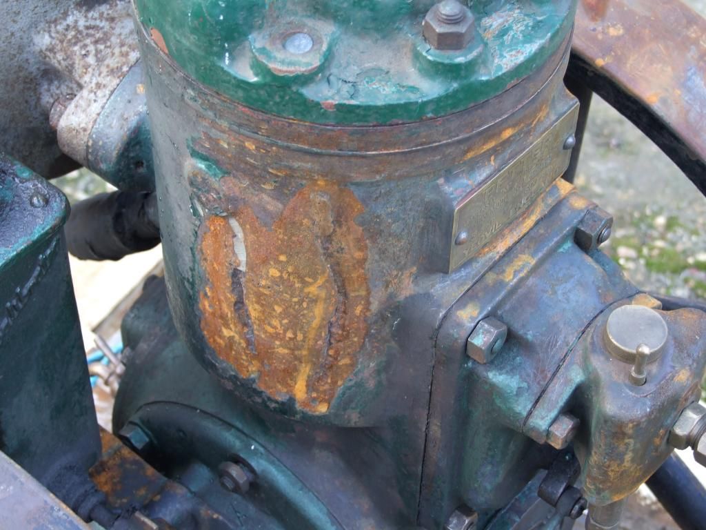

Sorry been away for a bit and other commitments I do apologise Hamish but I am now back onto it , I have goy the whole engine now stripped down apart from a missing pyramid glass for the calibrator lubricator it pretty much all there, I have now got a magnet and proper drive gear now, only major issue is the frost crack which I will repair and the other is the left side main roller ball bearing is rumbling after cleaning the dried grease in it, but has no play in it, do they settle a bit with fresh grease packed in ,also here is the chipped mag gear what do you think repair and weld or do I turn it round so the drive is not pulling on the chipped side , if you know what I mean

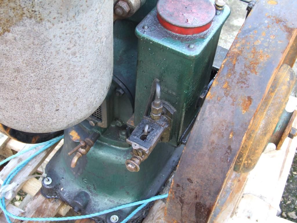

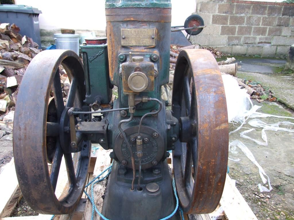

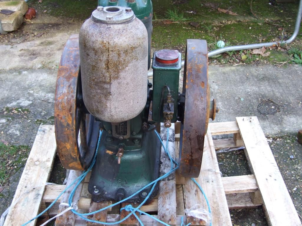

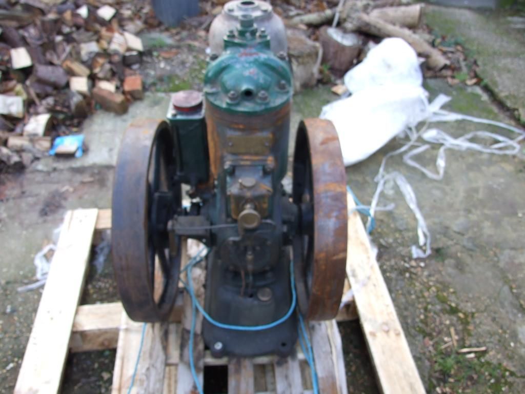

finally got pics of the engine petter m
finally got pics of the engine petter m and the chipped gear" />

That chipped gear will probably be OK to use as it is.

Looks like there will be just enough tooth surface left to be ok. I would test by fitting the mag, oiling up and turning over carefully to make sure.
I would think trying to repair or weld will be difficult and may cause further problems. Worst case you can replace the gear, crankshaft gears tend to be easier to find than the mag gears.
Dave
