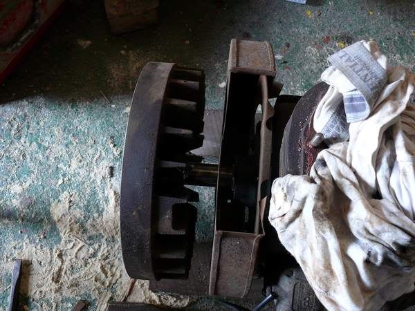

from the looks of it, the flywheel needs to come off to get at the next bit if tinware off, but i can't figure out what holds it together. i was expecting one of more nuts/bolts in the middle of the flywheel, but can't find them can anyone give me any pointers?
hi' i'm doing the same engine at the moment here
http://www.stationaryengineforum.net/t3372-my-first-engine
the pulley (if you have one) and the flywheel are keyed onto the shaft, both have to be removed to get that next guard off
behind the flywheel is this bearing cover
held on by 6 bolts, the tinware cover has 3 metal strips welded to it that also are held on by three of the cover bolts. it would help me if you could note the position of the arrowed lug on the bearing cover as it needs to go back in the right position for the oil grooves in the bearing and i forgot to mark mine before i removed it.
hope this helps you, read my topic to see how other bits come off mine is almost fully stripped now

had a look at getting the pulley of this afternoon. i can't get a drift in behind the key for the pulley, as it is in there tight. anyone got any suggestions?
thats OK, it means the key will drag out with the pulley if its tight up to the pulley you will not pull it tighter onto the key, just pull it off with the key still in. thats how i got mine off.

i never thought of that! i'll liberate a big puller from work tonight

It might help if you keep getting some WD40 down the back and the the keyway for a few days first. The pulley looks as if got a few coats of paint on it try cleaning it off around the keyway etc before you start.
Re: Petter A1 resto(ish)
finally got round to trying to get this damn pulley off. cleaned all the paint off the face of it, then gave it a daily dose of plusgas from both sides for just over a week.
took it in to work tonight and got a 10 ton hydraulic puller on it. not a sausage. couldn't get it to move even slightly.
anyone got any suggestions how i can get that key out?

There's always tryng to get some heat on to it, also if you can get in and hit it as the shock might be enough to break the seal. I've not had much trouble with mine so can't help much sorry.
i only really need to get it off to rebuild the bottom of the tinware, so i think i might see if i can repair it without taking the pulleys off

Nate wrote:had a look at getting the pulley of this afternoon. i can't get a drift in behind the key for the pulley, as it is in there tight. anyone got any suggestions?

Hi Bud,
put a bit of heat on the centre of the pully until its nice and warm, then get a bit of scafolden pipe with a notch cut out for the key.
When the pully is toastie hot, put the pipe aver the pully and give it a good whack with a decent size hammer, You wont have to knock it far, just enough to break the seal of rust.
By the way, Ive never got a flywheel of without cracking it so best of luck.
RAB wrote:Ive never got a flywheel of without cracking it
that's clinched it. it stays on there and i'll repair the tin around it.
cheers for the advise guys
