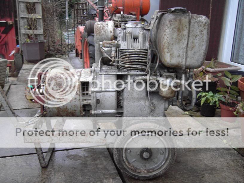

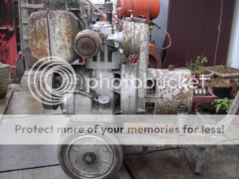

Hi again...
After quite some time - not just here - of trying to swap the alternator part of this little genset with only one sniff (thanks for the interest Ian Smile ) I had Stu echo what I've been thinking off-and-on for a while - maybe I should keep it...
Also I was going to use the engine for another (not yet public or even confirmed) project, but I'm thinking I want something with a bit more power for that.
Here it is:
Once again - surprise surprise - I'm not 100% on which model it is Laughing I'm fairly sure it's either an AA1 or an AB1, but not an AC1. There is no data plate on it, just some holes where it used to be. Any ideas on how to tell the difference apart from measuring the bore?
So what do you reckon, would it generate any interest (ho ho?) at a rally? I haven't been to all that many and exhibited at none. I'm not sure how popular air cooled fully enclosed machines are these days. Great eh - this and the little JAP and I'll have the dullest display trophy no trouble!
It's actually all original including the trolley (except the paint, and I do have the alternator end cover) - the cowls were removed and a mesh finger guard put over the flywheel/cooling fan as there isn't much of a load and they overcool easily - not good on a diesel. Main use originally was apparently for traffic lights or similar - maybe a display idea? A lighting rig or similar is the only use I'd have for a 110v generator anyway.
So as I say - it might turn into a project. I'll carry on the thread if it does.

Looks like 3 phase to me, in which case you may well be able to get at least 220v out of it, but I would need to know more to be sure.
I like it. As time moves on these more modern machines are making their way to the rally field, I certainly don't think it would be out of place. I like to see something a bit different to the "same old open crankers" anyway. Wink
(I'll put my tin hat on & run for cover now then) lol!
But seriously, it's variety that makes up a good stationary engine section of a rally, so it takes all-sorts really.

It's single phase, 4 field windings so 50hz @ 1500rpm or 60hz @ 1800rpm (to be determined if I experiment some more but probably 50hz), 55-0-55 on the three sliprings (if it is indeed 110v - resistance readings confirm it's centre-tapped either way). I'll do a quick wiring diagram and post it up later if you're interested.
I may be able to get it making a rather inefficient 220v but I'll need to make or find a decently rated rheostat or a big pile of resistors to play with.

One thing though, if it is 110v centre tapped it should feed nicely into a transformer, shouldn't it? That'd give you 230v.

I could run it through a site transformer backwards or similar to step it up to 220v, but as it's probably not much more than a 1kw alternator I wouldn't get a whole lot out of it.
I've had a look on ebay for rheostats and they aren't badly priced, but still over my tiny tiny budget Rolling Eyes It might seem weird, but as I have most of the parts it'd work out cheaper for me to build an electronic power supply to energise the fields! If I can fit it in the end housing so it doesn't show I might end up doing that...
As for colour, originally it would have been yellow. If I decide to do a 'traffic light display' with it I might go that route.
With your tarpen, the windings certainly look DC dynamo rather than AC alternator to me. There's going to be something in your thread shortly. Cool

I'm not sure this would have been used for traffic lights myself, it looks too big to me.
I've used some really ropey old traffic light generators/trailers in the past and I reckon this is more for building site power and/or lighting, either long strings of site light bulbs or some of the larger floodlight types. As for colour, yellow is OK but blue, possibly red as well. Unless it was a farm generator in which case green may have been a colour.
You may find some different colours under what is already there, just pick the one you like the most Laughing
I could be totally wrong but that is my educated guess.

It might be smaller than it looks...
It's dymo labeled to be fused at 5amps, which if it really is 110v would only give you 1/2kw - not much of a floodlight. Not saying it's not so though - I know a good few did end up on building sites, whether they went there new or later as surplus I don't know.
It's also possible it's supposed to have a bigger fuse in, I'll know more when I do some work on it.
Even so, the small loading was the reason for the removal of the cowl - the engine is quite over-specced for the size of alternator.
I'm half sure about keeping it now, I may yet waver on that again, but we'll see

For what it cost me (I'm not telling - yet) I think it's worth a bit of effort, it's complete apart from a couple of little electrical components. The paintwork leaves a lot to be desired but that's not a huge challenge.
I did notice a slight oil seepage from behind the flywheel, probably from the crank oil seal so that's something to look at. Of course, it may just have gone a bit hard from non-use and seal up again when it goes through some warming cycles, I'll have to see about that bit then decide whether it'll get a full strip or not. I think I'd rather not as even in the snow after not being started for about a month it fired up - 3 spins and drop the decompressor - no oil in the primer or anything, just straight from cold... Unknown age fuel too - it was in the tank when I got it.

IMO I reckon that alternator looks bigger than 1kw, looks more like about 5kw to me (OK, maybe I'm exaggerating a bit now). I thought traffic light gennies were tiny little things, more like a JAP 2a or something like that (these modern ones don't even have a genny any more, just batteries & LEDs).

It's strange with these old motors... The alternators are even worse.
If it IS an AA1 then running at 1500 rpm (to give 50hz on a 4-pole alternator) it's rated at 1.5bhp. That's just over 1.1kw from the engine. It might be an AB1 (pretty sure it's not an AC1) but even then you're only looking at a fractional increase.
Take a couple of losses here and there (bearing drag, cooling fans etc.) and you haven't got much more than 1kw left to play with anyway.
I know the conversions aren't exact and there is a lot more to it than that, but it's a ballpark thing and close enough.
Compared to a modern alternator, I agree it's huge for the apparent size, I've got a 3.5kva unit that's smaller.
