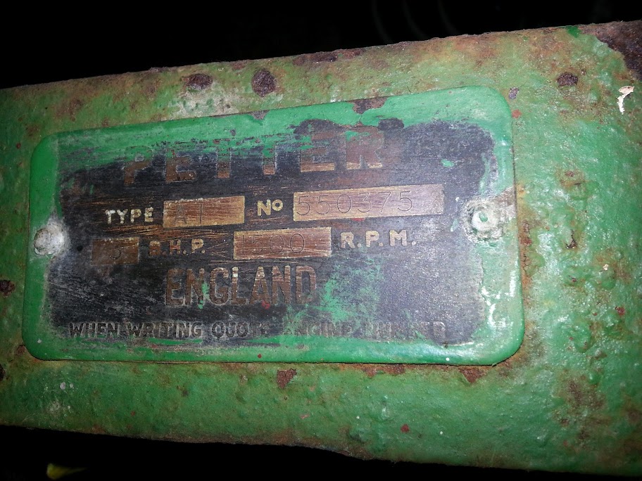

Hello all,
I have just been given 3 Petter A1 engines by a friend, they are all in poor states but I have taken the best from the bunch and plan to start resoration over the coming weeks - need something to do while the weather is so awful!
Anyway, letts start with the pictures:
Petter A1, engine number 550375, 3 BHP

looking at the number a rough date would be
543565 to 557999...................... 1948 - 1951
the petrol tank looks like a Lister D one, Petter one's are round.

hob wrote:looking at the number a rough date would be
Yeah, I thought it was probably the wrong tank... I will see what I can do once I get it up and running Very Happy

sjs205 wrote:Hello all,
I have just been given 3 Petter A1 engines by a friend, they are all in poor states but I have taken the best from the bunch and plan to start restoration over the coming weeks - need something to do while the weather is so awful!
Steven
what are the other 2 engines like? and do they have mags with them.
