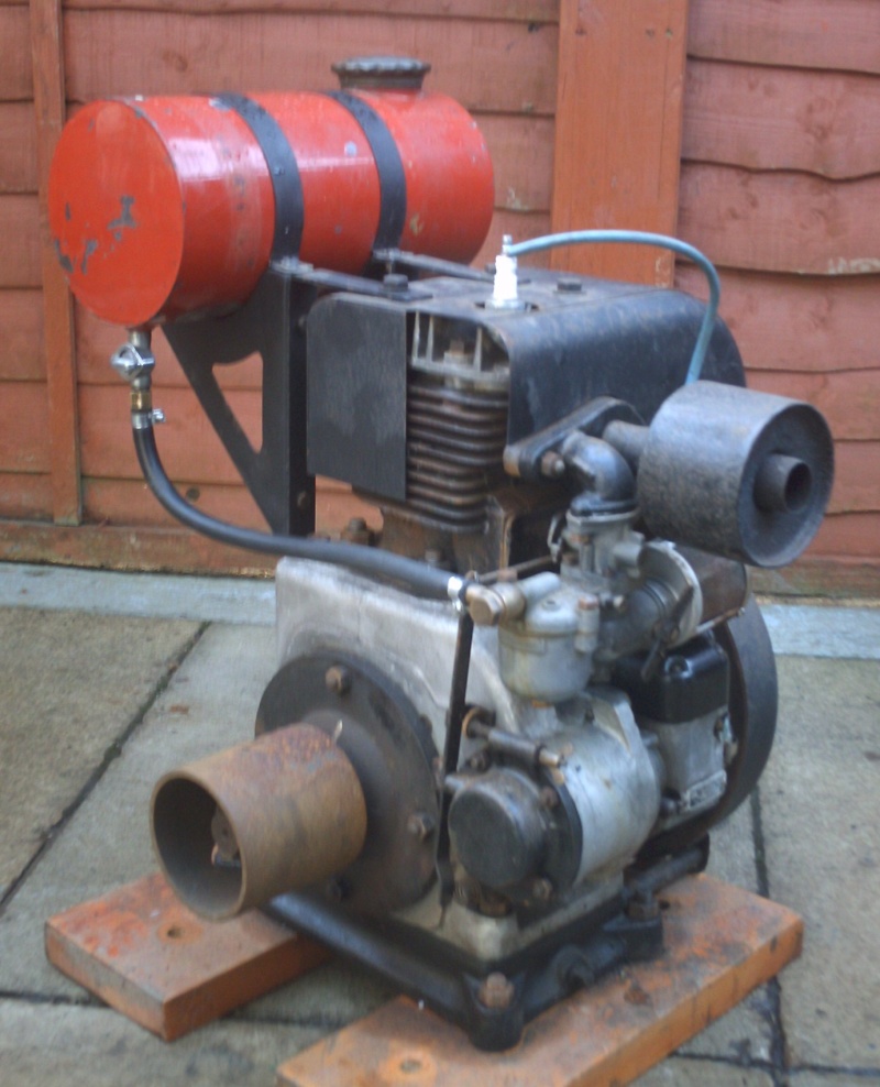

and look what followed me home.
its a coborn b23. i will post more information later.

Re: a trip to bradford.
It's suprising just what can follow you home these days nice find, looking forward to some more pics and some more info on the engine and your plans.
Interesting looking engine, I thought it was one of the bigger J.A.P.s at first.
Can't wait to hear a bit more about it

an update.
i found a coborn tank in the back of the shed, so the non original tank has been replaced. the mag now sparks i just gave it a good clean and unstuck the points, it now gives a nice big strong spark. next job is to get the head off and have a look at the valve.
richard.
richard.

All sounding good Richard, lets hope there's no scares once the heads off.

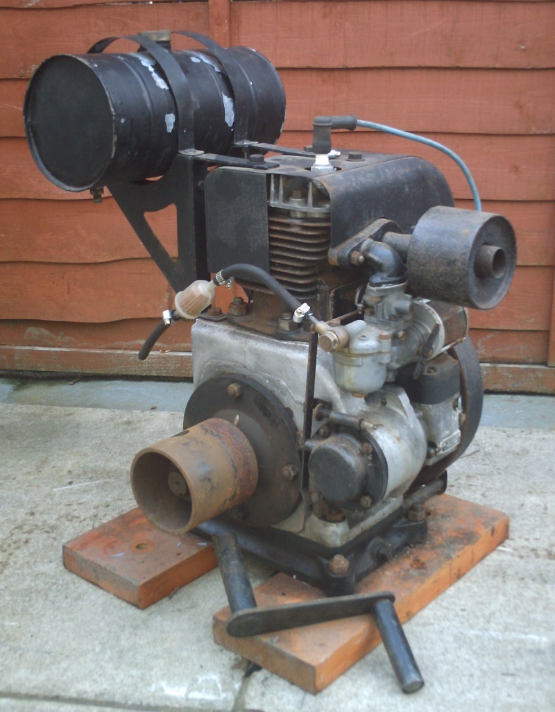

with correct tank.
the coborn with the correct tank. the valve is now unstuck and the engine runs well.
richard
richard
Great news you've got it up and running, so what's your next move? strip it and paint it over the winter.
winter work
the engine will be put to one side while i concentrate on some other projects. the engine will be stripped and painted early next year.
That old tank looks like it would fit mine & Ian's Briggs & Stratton RC. Don't suppose you know what it came off???
BTW, I've been following this one with interest but, as yet, couldn't think of much to say. I've always liked the old Coborn engines, but it somehow doesn't look right in black. I thought they were all red?
So you can guess my next question.... What colour are you going to paint it?
Best of luck with it anyway, I will continue to watch with interest.
the engine will be painted red. the tank came off a seized c3 engine.
richard.
richard.

it's stopped raining
as promised, a photo of the coborn on its new heavy trolley. the engine can be run at a good speed and does not move around on the yard floor.
richard.
richard.
Nice looking trolley Richard.
Good luck with the painting and please keep us informed of how you get on.

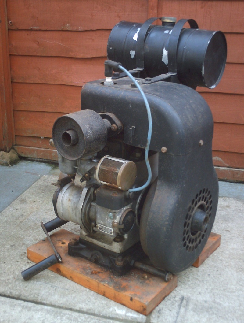

the final colour choice.
decided to go with black as I could find no traces of an original colour so I think it must have been black in the first place.
just need something to run from it now.
Richard.
Richard.
Well, I like it in black (not that it matters what I think really). You'll probably get a lot of people asking what make it is.
