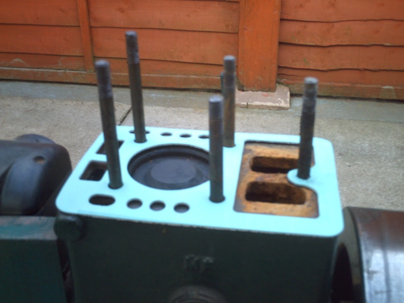

fitting the head gasket
we fitted the new head gasket and refitted the carb, exhaust and hopper tops. Daisy made all the new gaskets as we went along.

Re: my daughters first engine.
What is that head gasket made from? It looks an odd colour. I'm always interested in new materials, especially if they're easy to cut & do the job, & I will probably be looking for a Lister D head gasket myself soon, I don't fancy paying Stationaryengineparts prices for one either.
They are a composite material and I use them a lot with no problem. Scroll down Brian's catalogue.
