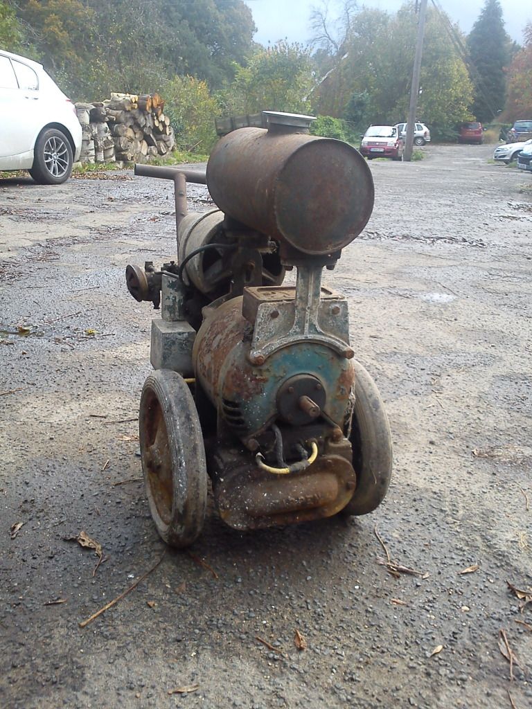

Righto, lets get this one back on track. (not that I mind at all, I find it quite interesting hearing about all the different ideas where wives & families are concerned).
I finally picked up the engine yesterday, but as I was still on my long weekend camping trip (I stayed reasonably local) I haven't been able to report until now due to dodgy mobile internet signal.
So, here she is....
She might look a bit bad, but she's all there, everything's moving & turning as it should be & the fuel tank is pristine on the inside. I even got some history as well.
Apparently it was originally sold, from new, to a place called Scotney Castle near Tunbridge Wells on the Kent Sussex border. They were taken over by the National Trust & eventually the Tarpen was sold off after a clear-out & went into the hands of the owner previous to me, so it's almost a one owner engine!

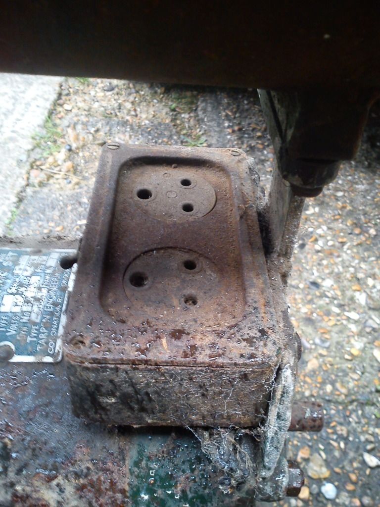

There are a few very slight differences to my other one, there are some pieces of metal around the throttle governor mechanism....
There is a double socket, instead of a single....

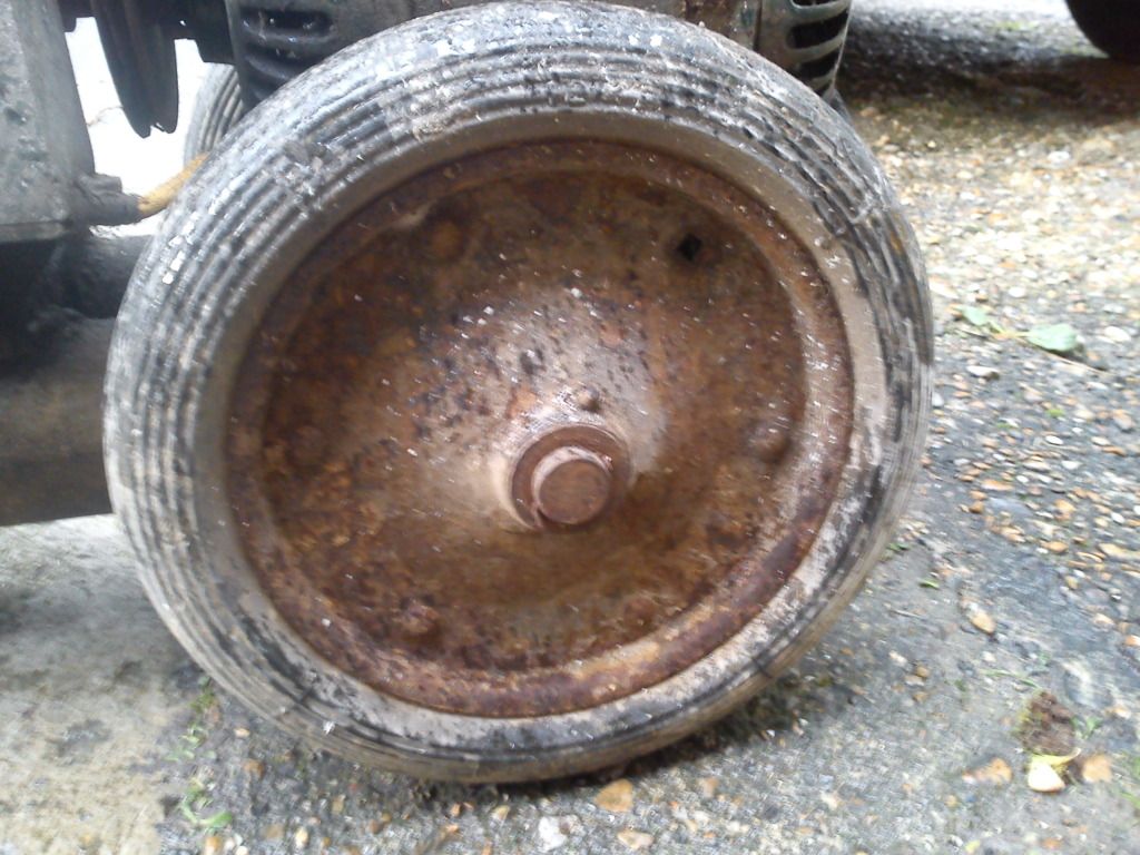

& the wheels are of a slightly different design, but are still pressed steel, not the later cast aluminium ones....
But, identical to the other one, this one only cost £25. The only thing is the other one was purchased by my family around 1986, so I reckon I did quite well.
This was advertised as being possible 1950s, but I know well that this particular model was around in the mid-late 1930s (I've seen adverts for them from 1936) so most of them are in fact pre-war (it's a common misconception, even I always dated them around 1948 until recently). I now believe the engine to be a Villiers derivative, but I'll get to that later.
My plan is to restore her over the winter & sell it on in the spring, but I might well end up keeping her (I like the fact she comes with such a comprehensive history), we shall see.
She is now safely tucked up in Ian's garage, I will start to dismantle her over the next few weeks, bring some lumps home, restore these lumps & return them to Ian's garage for later reassembly. Well, that's the plan. My dad might just find a Tarpen slowly grows in his workshop over the winter as I move it in gradually (I like to keep them close if possible).

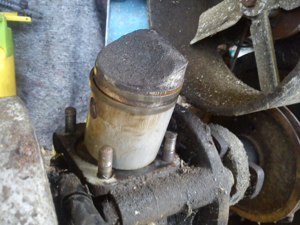

Post by nutgone on Thu Nov 01 2012, 23:52

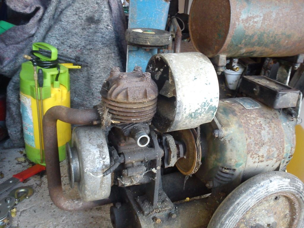

I got to work dismantling this one today & I've ended up with most of it in the boot of my car. I'll let the pictures do most of the talking....
I started by removing the carb, throttle governor & some cowling....

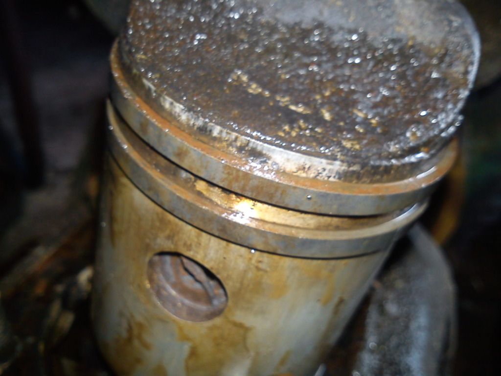

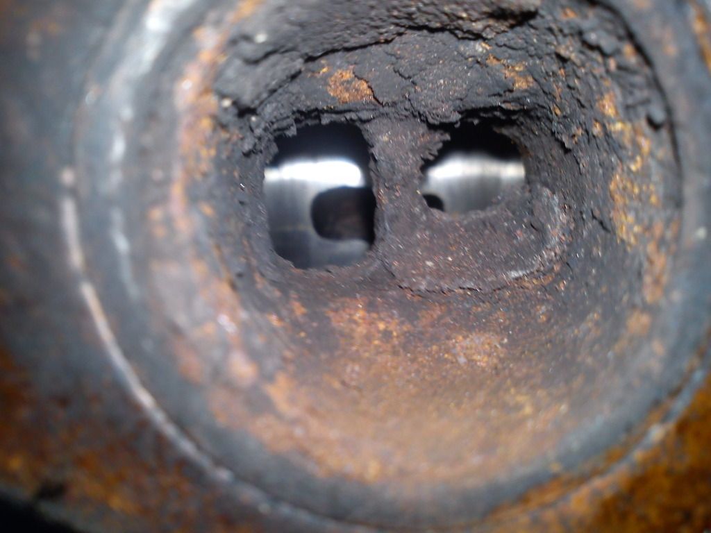

Then I thought I might as well whip the head & barrel off, but found the top piston ring to be stuck solid....
So I gave it a quick spray with GT85 & checked out the barrel & ports. The barrel is fine, but the exhaust ports could do with a de-coke....
So, less than 5 minutes later I go back to that piston ring. After some very gentle rocking I get both ends to spring out (need to be careful here, they're cast iron rings, very brittle & I don't want to have to replace them!) But sure enough, within 5 minutes it's free once more....
Great stuff, that GT85. I've used it on rings before, but the main trick is patience. However, there will always be those times when you're never going to get it out without breaking it. Gladly this wasn't one of those times.
So I carefully put the head & barrel back on, finger tight, & continued with the strip down. I removed two of the nuts from the canvas coupling between engine & genny, took out the 6 bolts holding the engine to the chassis & lifted out the engine....

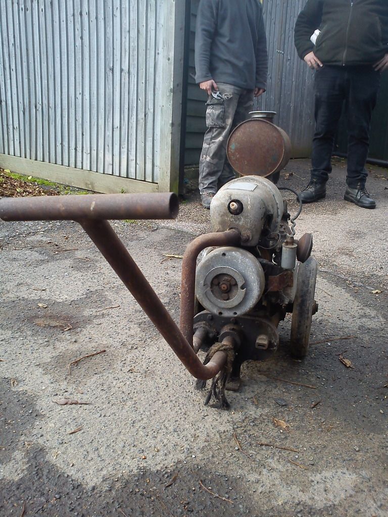

I also removed the fuel tank, the wheels & the front & back covers from the chassis/exhaust system. I felt I had to leave something behind in Ian's garage (it would be rude not to) I also didn't want the full weight of a Tarpen in the boot of my car (something would likely get damaged the way I drive!) So here's all that's left....
& what do you know! You CAN fit a Tarpen in the boot of a 1980s BMW 5 series!....
Well, almost. Very Happy
