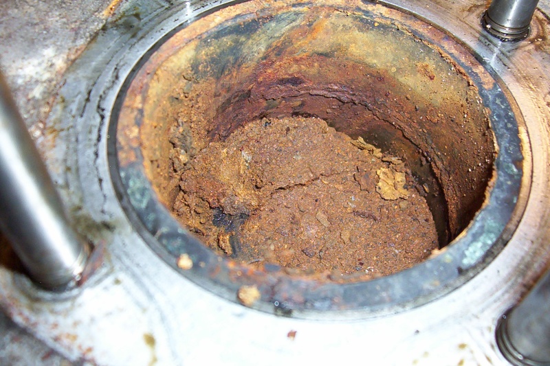

well stu
ive got around to taking FODEN petes advice on head removal and it splits half way down the lenth of the engine cooling fins,
as for it running 6-9 mnths ago
well have a look at this
this is some of the rust out the top of piston bore the card its at on is the size of a mug bottom
Re: villiers D270 aircooled diesel to the collection
Is it a write-off then Kev, or will you see if it cleans up?
A petrol engine like this could probably run again, but a diesel could be a different story, they really need all their compression.
Gutting, aint it?
Gutting, aint it?
nutgone wrote:Is it a write-off then Kev, or will you see if it cleans up?
Gutting, aint it?
