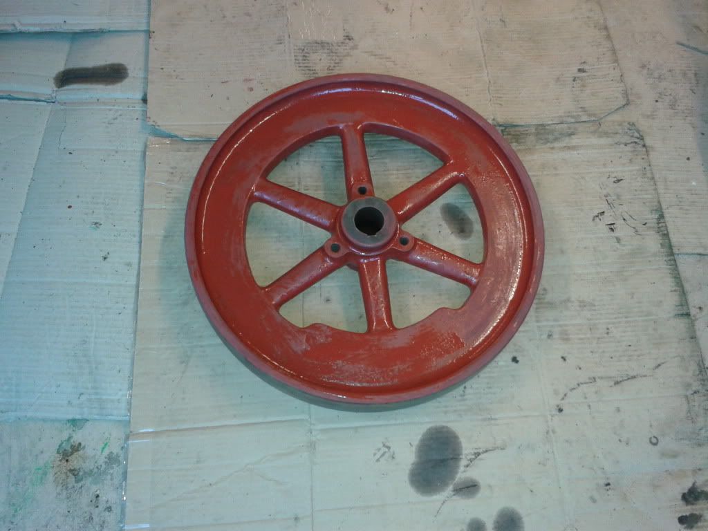

Like I said, I'm sure it'll look fine. I probably shouldn't have compared it to the other shades of green.
Re: Nutgone goes all Lister! (Lister A tank cooled project).
nutgone wrote:Like I said, I'm sure it'll look fine. I probably shouldn't have compared it to the other shades of green.
Yep, but its annoying when you see a colour you like, order some and it turns out completely different! Looking at the sample of Lincoln Green, I really liked it, but in the flesh I'm not so sure. Luckily that's not my engine and the owner wont worry what colour it is so long as its green runs perfect and doesn't leak oil! As your not likely to keep the Lister then so long as the tin says Mid Brunswick!

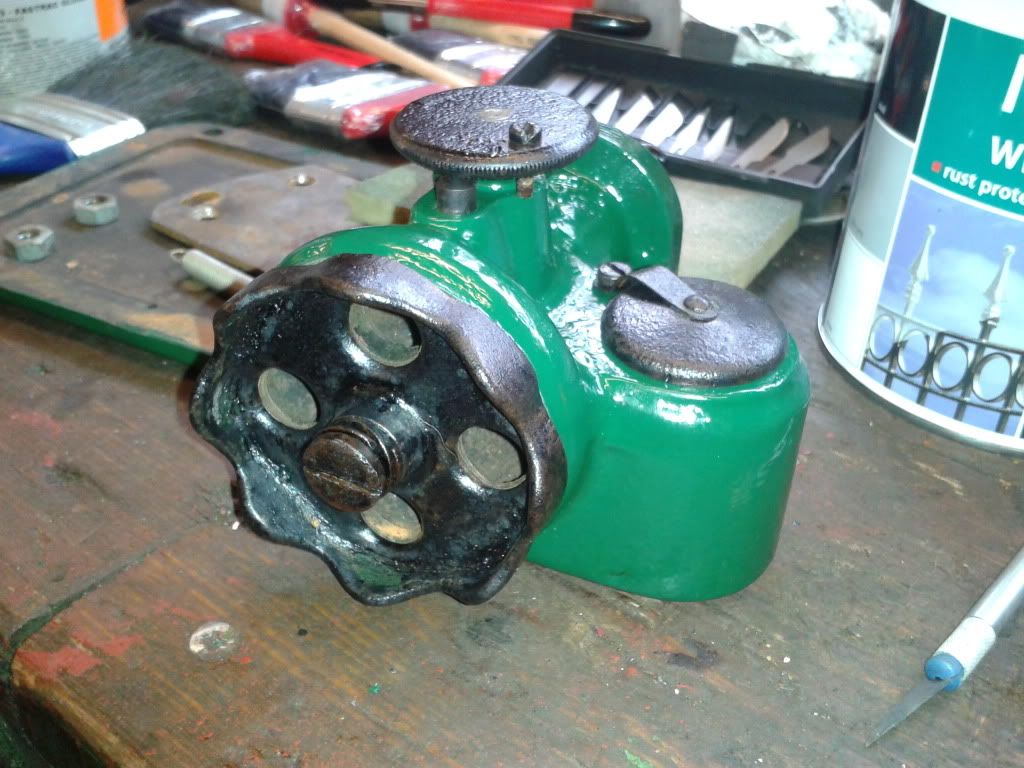

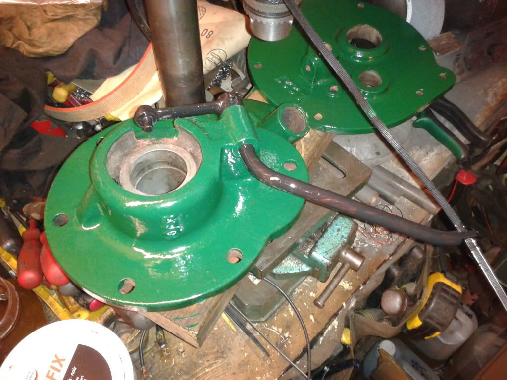

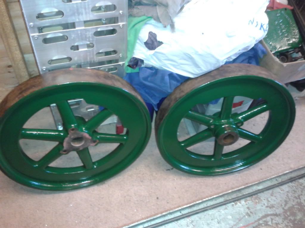

Blimey! It's bee a while since I said anything about this one. I've been getting side-tracked with the Bamford, trying to get it apart etc etc. (& largely succeeding, as most of that one is now in boxes). But one night last week (possibly Wednesday, could've been Thursday) my dad was out at one of his old bike club meets & he'd taken one of his old bikes, so with the extra space in the workshop for the evening I thought I would get some work done on the Lister.
I started by prepping & painting the flywheels, which have just been propped up against a fence since they came off, with their first primer coat. I used the wire brush on the drill (which is getting very worn down now, I must get a new one, & a couple for the angle grinder), most of the old paint wasn't coming off though, I guess it's original, some of you may gasp in horror, but I don't like the working clothes look much, they never look finished to me. If I had one that was a bit special & had original paint left I would consider leaving it, but on the whole when I do a restoration I like to do the whole thing & paint the nuts & bolts as well (it's just my way, there are many others, none are right or wrong really). Besides, this one didn't have enough original paint left in any case.
Anyway, here they are....

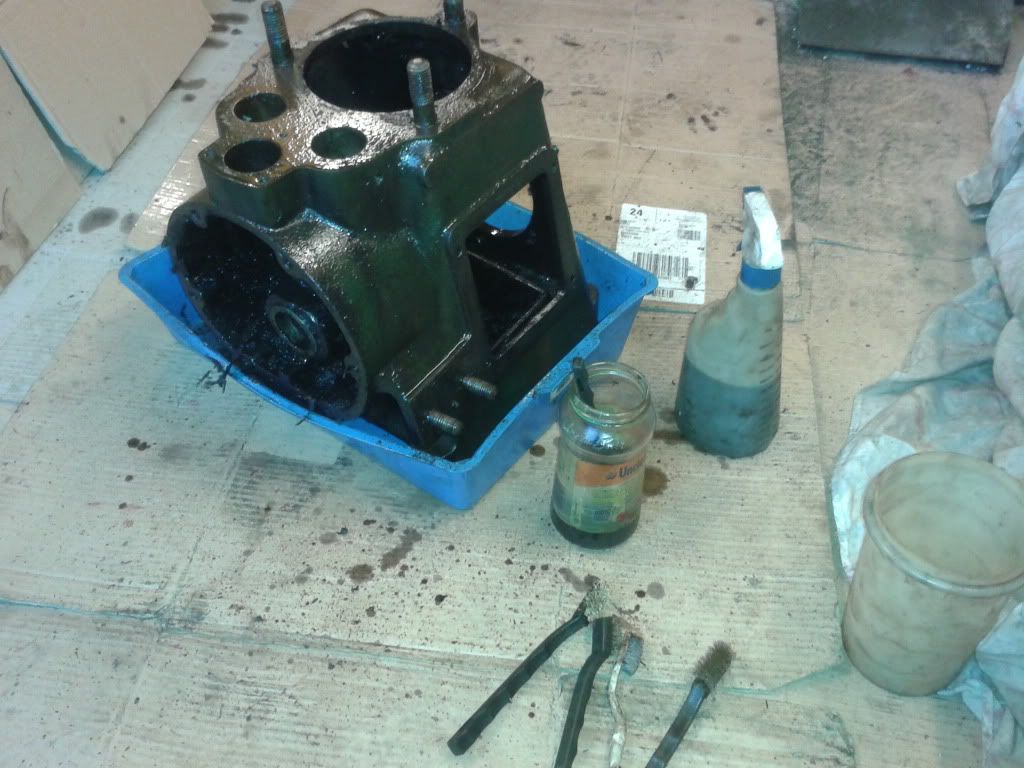

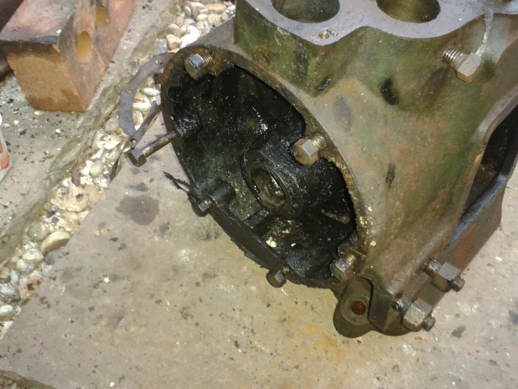

Then I thought I'd better make a start on the crank case. A few days earlier I had emptied out the special oil absorbent granules (AKA expensive wood based cat litter that our cats didn't like) & the crank case is the last of the bits to be cleaned (well, there is the base, but that's not in the same league of dirtiness). It's one of those jobs I hate! It needs a professional steam cleaner/hot wash with a load of industrial chemicals, but all I have is an old cat litter tray (now cracked), some home made easing oil/parts wash solution & a selection of different brushes & scrapers....
Well I gave it one good go, then rinsed off with brake & clutch cleaner. Then I gave it another go & rinsed off again. It could go back together as it is, but it wouldn't be right & I wouldn't be happy with it, so I've ordered some industrial chemicals off eBay & will give it another shot. I've also sprayed it with my home made easing oil/parts wash solution, as I have recently discovered this stuff is really good for de-coking engines, it gets stubborn carbon deposits off really quickly, so it might be good on some of the more stubborn caked on crud in the timing chest area (that's the worst bit)....

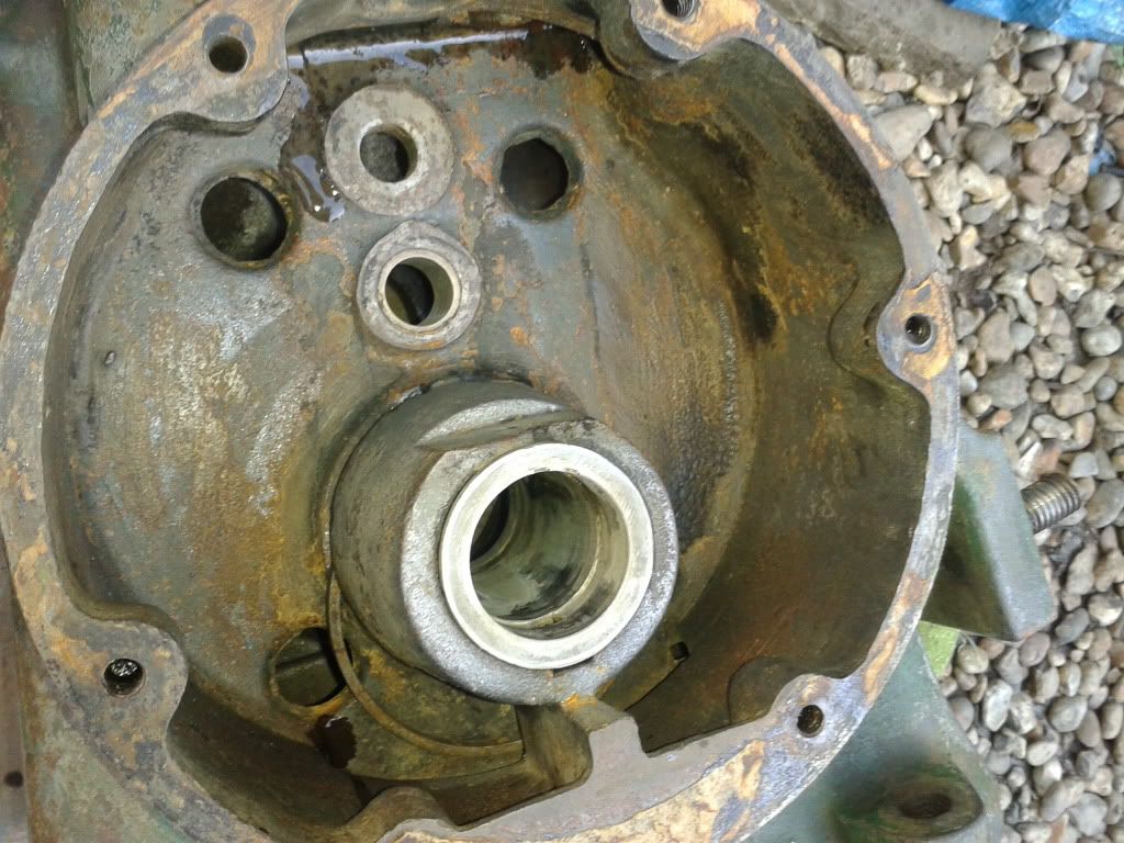

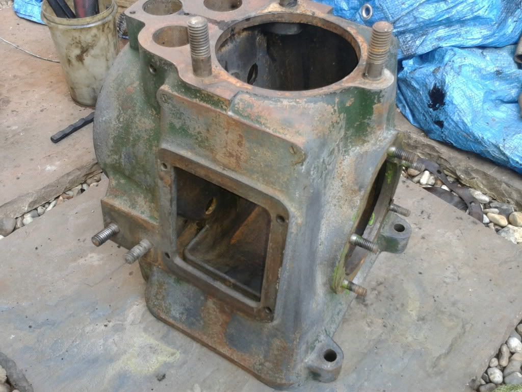

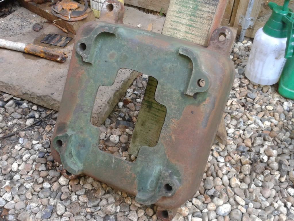

OK, been a bit busy with this one today & a few days ago, cleaning up the large pieces. I've also been getting side tracked with other stuff, like welding up a stand off a Triumph 3T motorbike (I show a bit of promise with our old oil filled arc machine & suddenly I'm a welder , getting called upon for all sorts of welding jobs).
I've also been struck down with a mystery illness (probably a stomach thing, didn't last long), a piece of metal in my eye (have now ordered some safety specs ) & today have been struck down with a bad back! (I'm blaming that one on the cats) Still I have persevered, as much as I can....

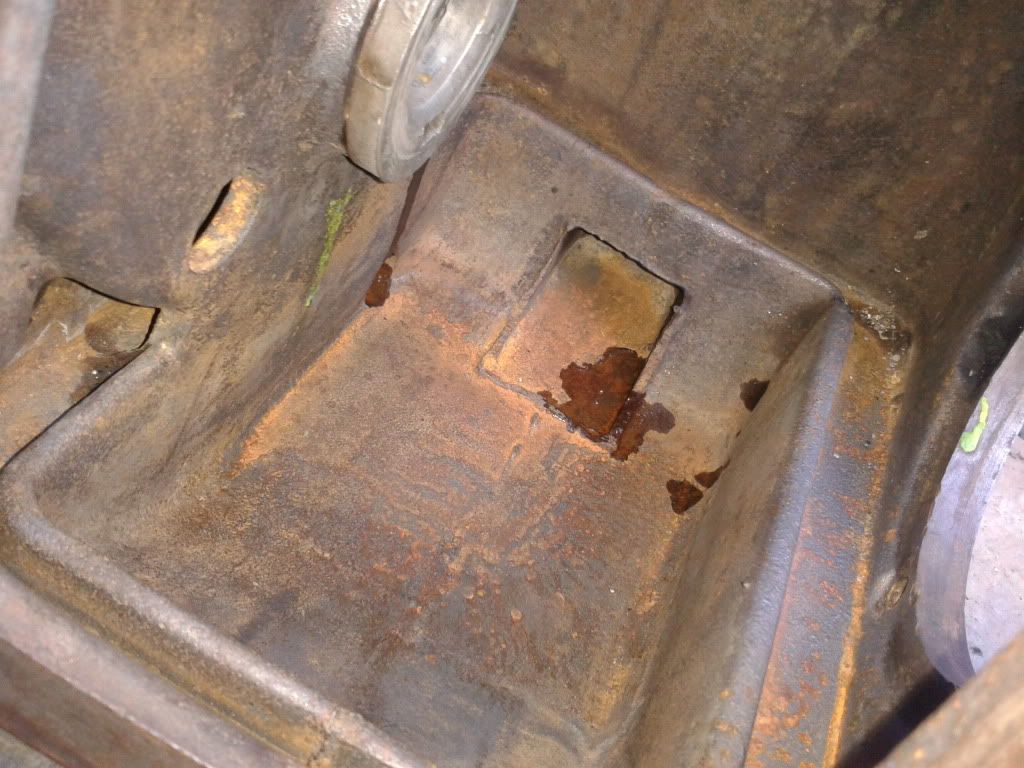

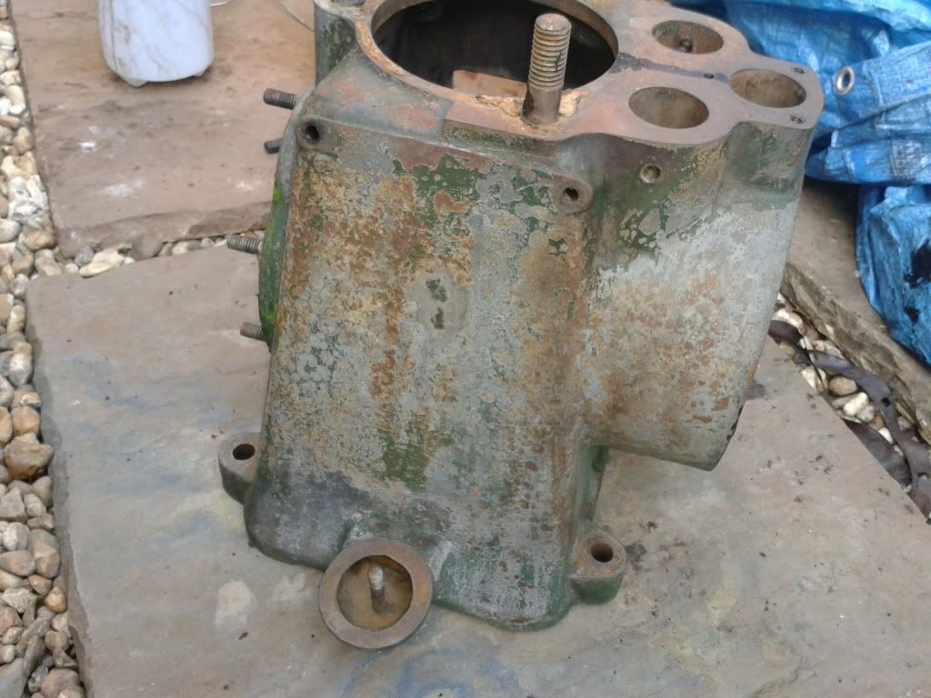

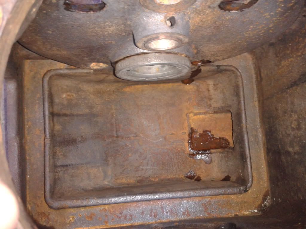

My problem was the crank case. It was badly encrusted with caked on grime, the oil trough (a silly design flaw anyway) was pretty gunged-up. Previously I had a go with my home-made easing oil/parts cleaner, but it was very slow progress. so I searched eBay & decided to invest in some proper industrial chemicals....
On the left we have what was sold to me as a powerful engine de-greaser. It turns out to be a water based industrial strength floor cleaner. I tried it out neat & it wasn't much cop, so I read the instructions & discovered it needs to be diluted with water, at least 10:1 for the toughest jobs, & up to 200:1 for general light cleaning! (so pretty strong stuff). So I mixed some up at 10:1 & it is very good stuff. At least as good as Gunk or any of the others, & should last ages at those light dilutions. Also it's water based, so doesn't have to be caught & disposed of specially (luckily I'm working over gravel/stones, which act as a good soak-away).
On the right we have "Special D" parts cleaner. This is hydrocarbon based (hydrocarbons are basically what petrol & diesel are made of) with added detergents & is basically what is used in garage parts wash machines. It smells like diesel & can even be diluted with diesel, paraffin or kerosene. It should not be washed away, but should be caught & re-used, so I'm adding it to my home made parts wash/easing oil solution (I hope it doesn't ruin it's easing oil properties). I noticed it tends to settle out the crud & dirt very quickly, you only need to leave it for a short while & it settles out quite nicely, leaving the sludge at the bottom. This chemical is flammable though, so care should be taken. Also, it's worth wearing gloves with both of these chemicals. The parts wash isn't so bad, but the de-greaser stuff made my hands itch very quickly (& I never normally wear gloves, these things don't tend to bother me). Good job I bought a box of nitrile medical examination gloves at the last rally.
So basically we have 2 very different chemicals which both do a similar job. I decided to start with the parts wash, over a large oven tin/tray type thing, to get the real stubborn stuff off. I used some kitchen scourers (like Scotchbrite) & the usual wire & nylon brushes, then rinsed down with some brake & clutch cleaner & put what came off back through my filter system & into my recycled parts wash bottle.

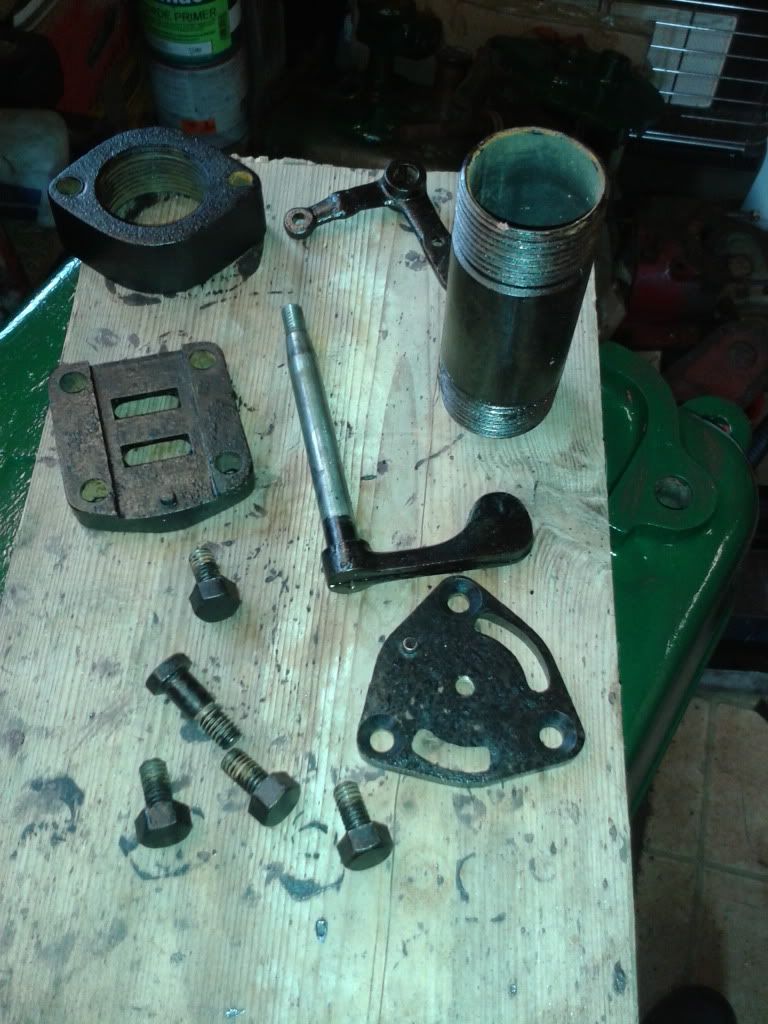

Then I went at everything with the engine de-greaser (floor cleaner stuff). I got some more kitchen scourer & went at it all in much the same way. I then rinsed it down with more of this de-greaser solution (as I don't have to catch it & it's largely water I could afford to be decadent with the stuff). Then rain stopped play, so I left the crank case out there to get rinsed off naturally.
The next morning it was rusty! I couldn't believe it! I think it was more the corrosive properties of the de-greaser that caused the rapid surface rust, but it wouldn't rust if there were oil or grease on it. Don't get me wrong, it was still pretty cruddy in a couple of places, but the chemicals had done a very good job. My only problem now was the lack of a spray bottle. I've put brake & clutch cleaner through all my trigger spray bottles & it's broken every single one, so I ordered some of the pump spray bottles & just had to wait for them to arrive.
So today they arrived & I repeated the above processes once more. This time I got a bucket of hot soapy water to rinse off the final de-greaser after a good scrub down. This seems to have helped a lot, but really it is only a rinse. If I had a jet washer I would've used that instead (the water based de-greaser will rinse off with just plain water)
Here's the results....
Any moisture you see in those pictures is just water, there is no trace of oil in there. So I'm happy with my new chemicals. I will post up some links if anyone's interested. I know the company is called "Spacialised Aerosols" & that is the name of their eBay shop. Those chemicals are available in 5 litre or 25 litre containers. I bought 5 litres of each, but may get bigger next time (I didn't want to buy big containers in case it was rubbish). But I may give some others a try.

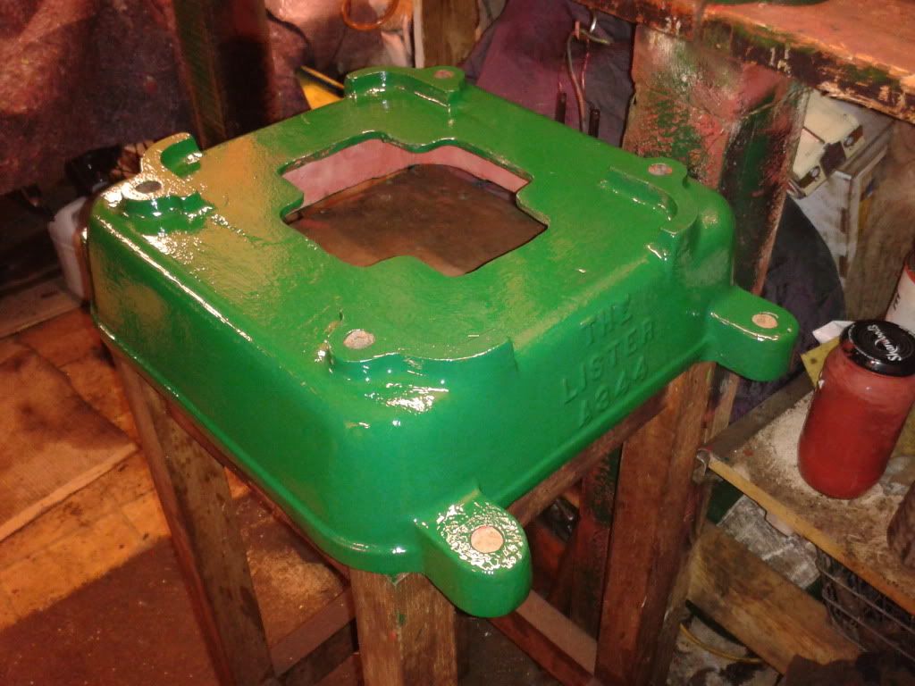

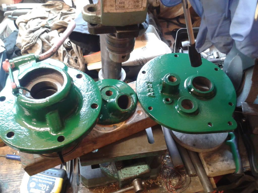

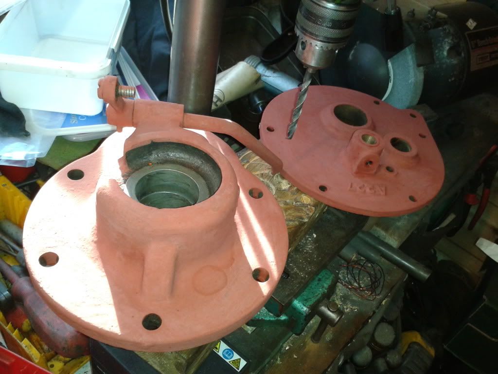

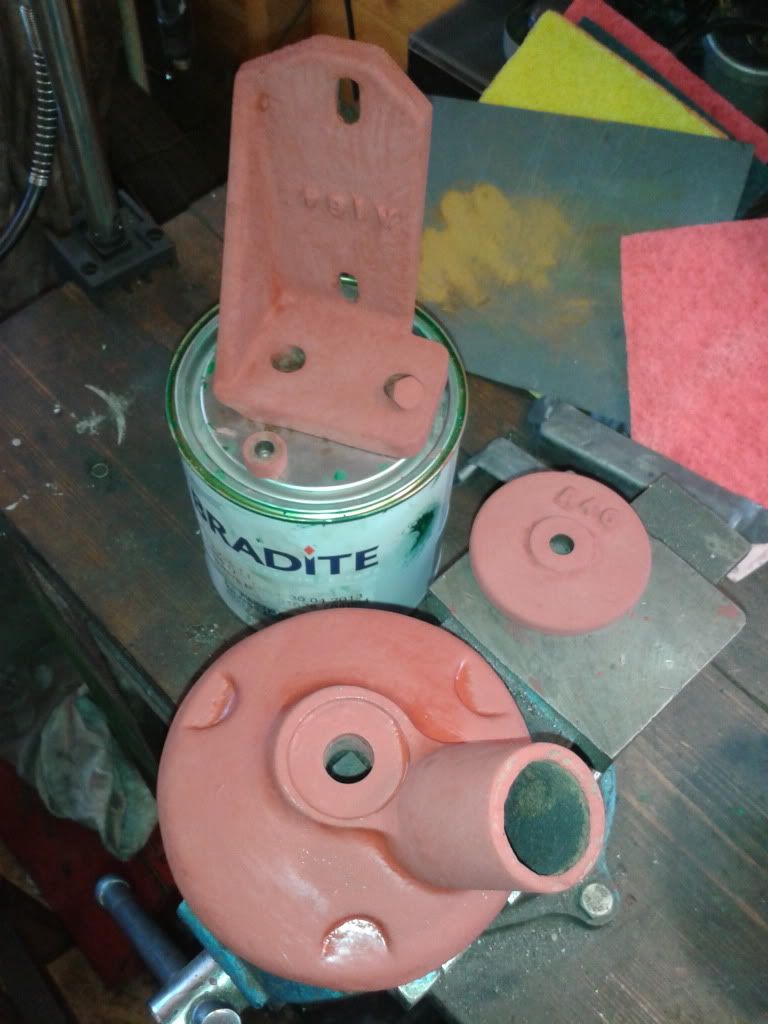

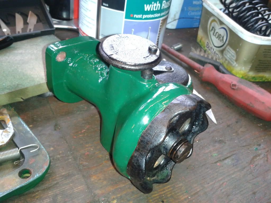

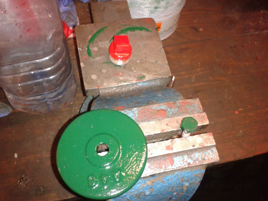

Busy busy busy! I've had some paint brushes out these past few days, cracking on with the Lister....
I'm not going to paint the crank case until I get my new wire brush wheels. I'm very anxious to make a real nice job of this one.
Looks really good matt, what paint company do you use?
Teamac primer (great stuff) & I use Bradite ME53 Fastrac enamel paints for the top coat (you can get that stuff from most good paint suppliers, I like it, but I usually thin it down a bit for the final coat).

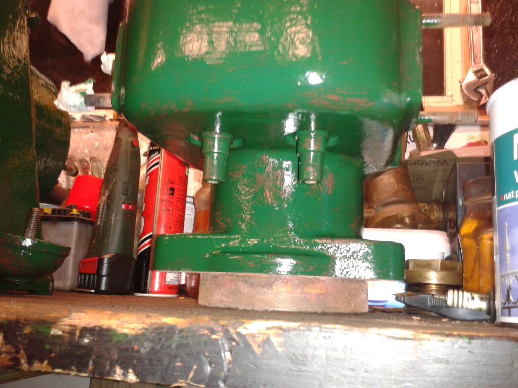

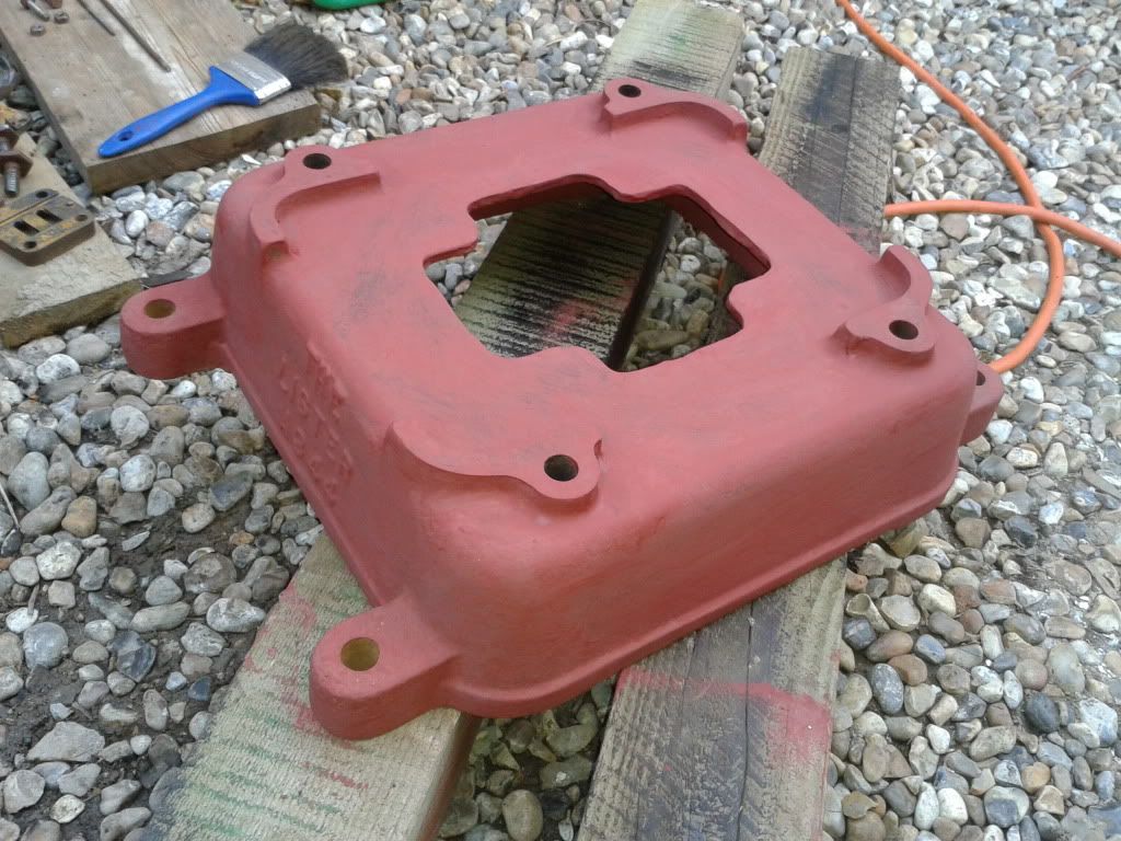

Well the wire brush grinder wheels turned up today. Blimey they're evil things. I had been warned about them & told they're not like the drill powered ones. So I wore my overalls, gloves & eye protection & had a go.
I was told that these things really do "Take No Prisoners" & that information was indeed correct. No loose clothing, no letting the power cord to get in the way, these things are nasty & they do take metal off (you can see the sparks), so extra care & caution to anyone out there who is thinking about using one. Wear good, thick gloves & good quality eye protection. Something flew up at one point & got me in the neck, but fortunately it must've been a bit of paint or something, as it didn't bed in or draw any blood, but it damn well hurt! So take it easy with these things people.
Anyway, what a brilliant piece of kit for cleaning off old rust & paint! I've really cracked on with this one today. I think every piece has now been at least cleaned, if not completely de-greased, rinsed off & primed.

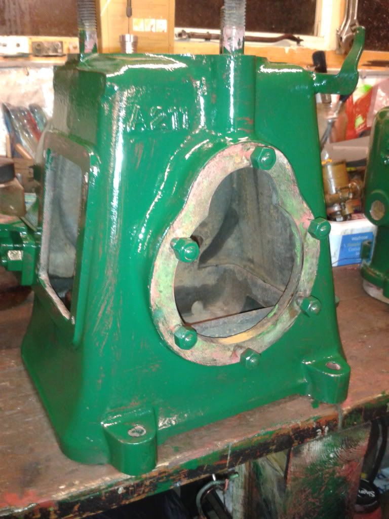

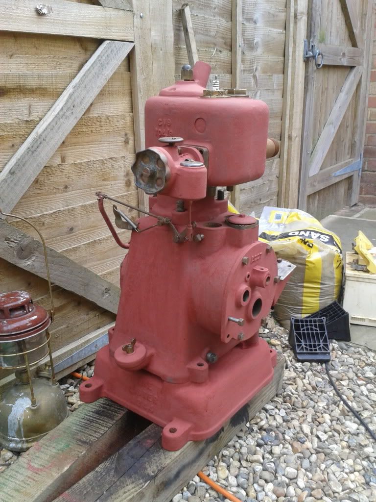

Here's the latest bits, the crank case has finally got a coat of primer & the base got it's second coat....

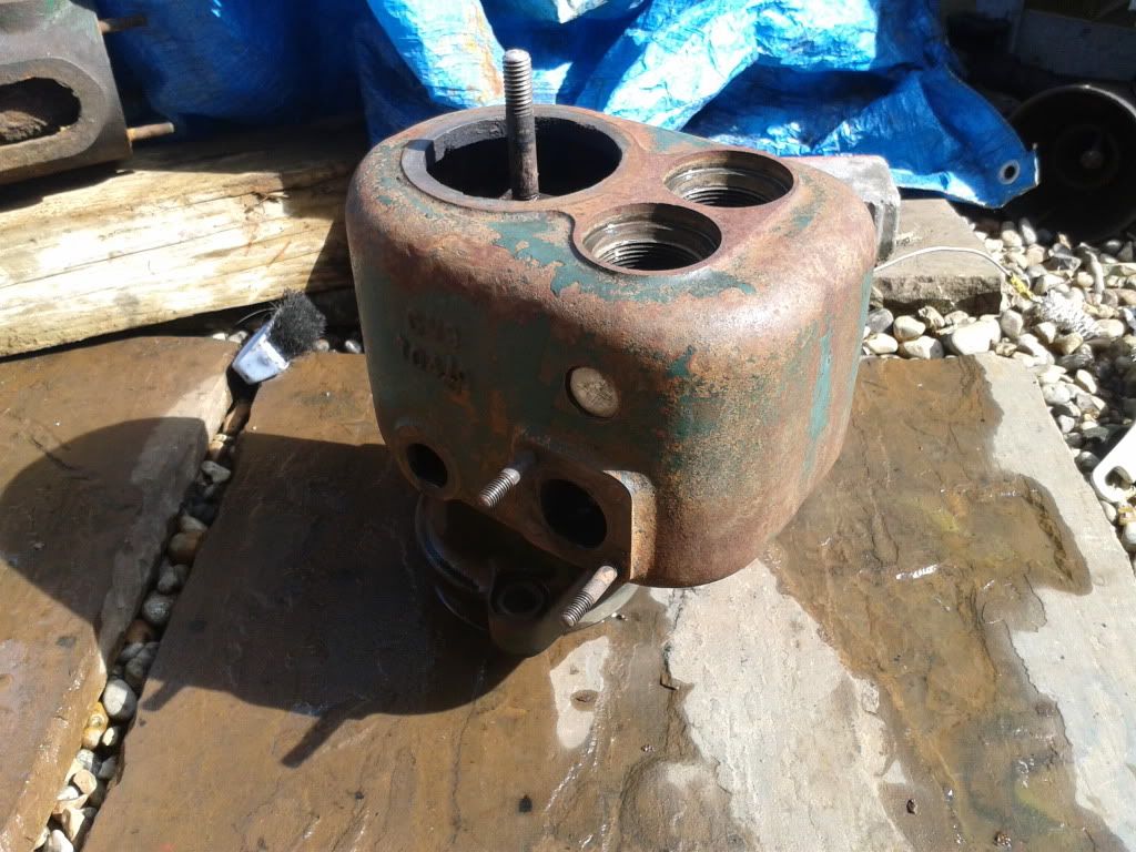

Then I set to the barrel/head piece with my newly acquired chemicals....
Then that got attacked with the wire brush grinder attachment & got a coat of primer....
So, just the crank case & barrel to get a compulsory 2nd primer coat, then I can start thinking about putting it together.

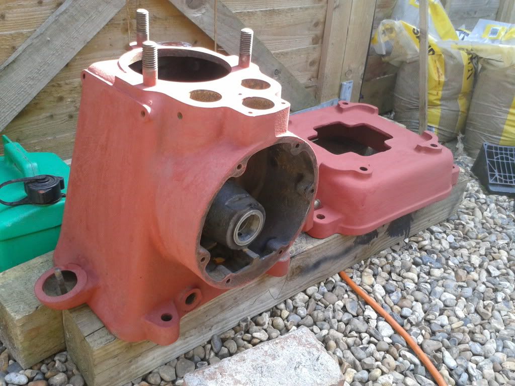

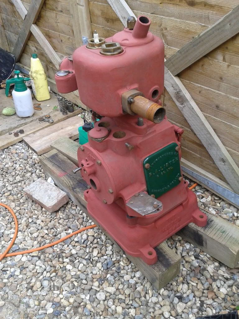

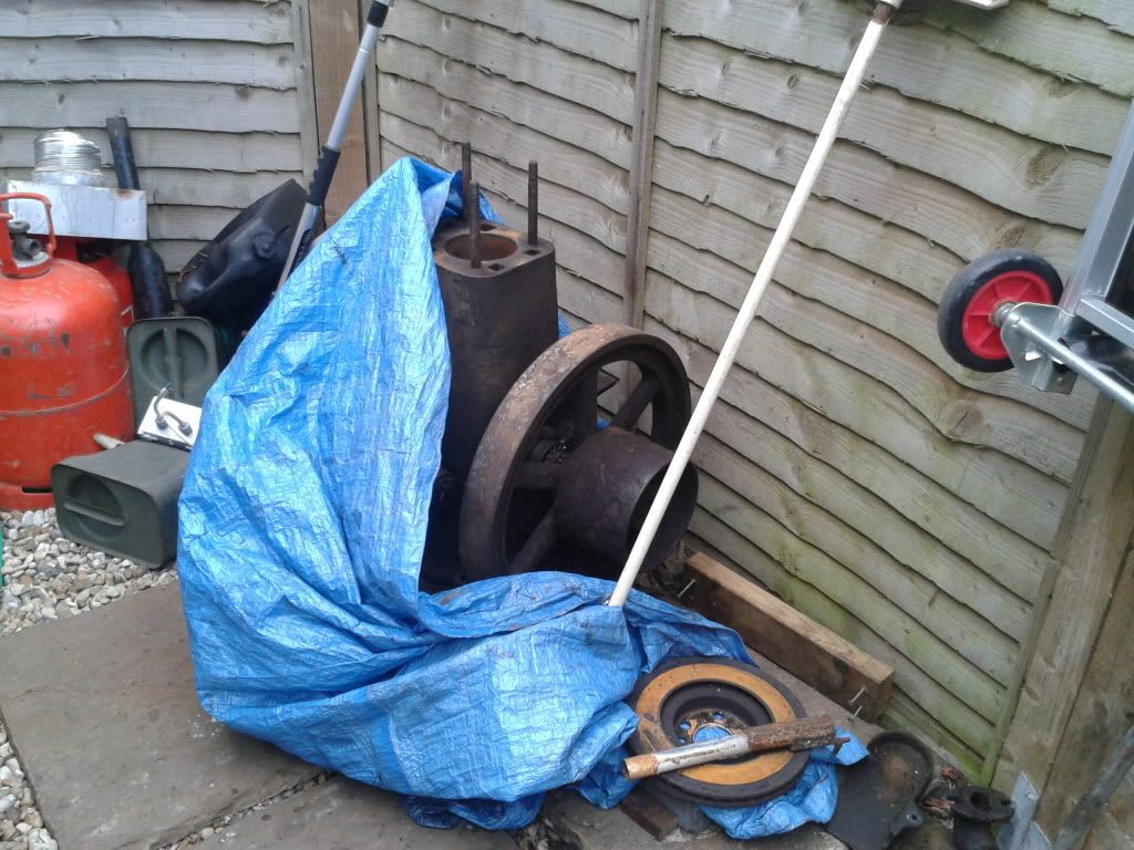

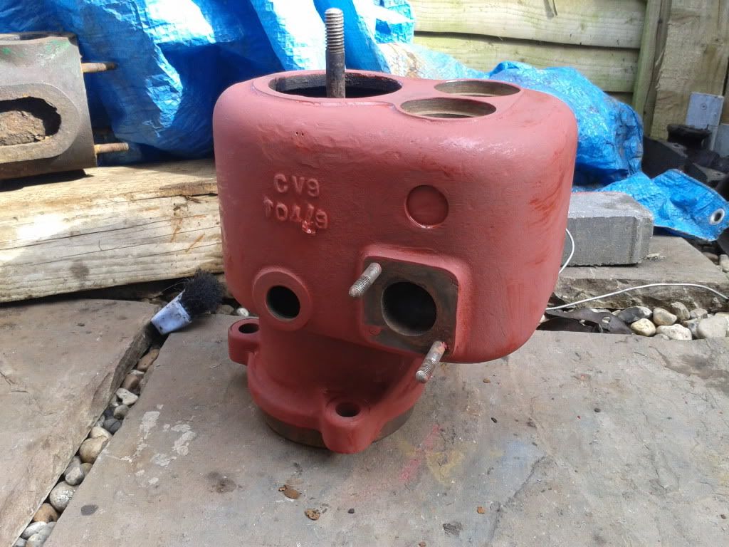

It was too late to take pictures the other night, but I had a little play about & ended up with this little sculpture in the garden (all done up finger tight)....
Now, I know the term for an engine with no head (or no head & barrels) is a "Short" engine, so what's one like this called??? A "Narrow" engine perhaps?
Anyway, it must have got rained on last night (didn't cover it up), but there's no internals, it's just a bare shell, I just wanted to see what it looked like & I wanted all the bits out of my way somewhere, this seemed the logical choice.

OK, so I've come back in especially to post some pictures for you lot (well, I actually came in to watch Countyrfile, but I guess at the age of 33 I probably shouldn't be admitting stuff like that).
Anyway, here goes....
I've treated a load of different bits with the Kurust for them to look something like natural blackened nuts, bolts, bits & bobs without actually painting them & not just leaving them to go rusty in time (the glossy finish will dull down in time)....
I've also given both wheels a 1st & 2nd gloss coat (not sure if they'll need a 3rd or not, will see what it looks like as it goes back together)....
I also gave the crank case end plates a 1st & 2nd coat. The governor arm has been left & will be painted black....
The main engine parts (crank case & head/barrel) have now had 2 good primer coats & will get their 1st top coat tonight. The base has had it's 1st top coat & will probably get it's 2nd tonight as well (note the Kurusted bits which will not be painted)....
& finally onto the carb. This will have a mixture of painted body & kurust treated bits. It has now had it's 2 primer coats, sand back & 2 top coats & the bits have been kurusted. I am anxious to get this done early as it needs to go off properly & then be sprayed with petrol resistant lacquer. I loosely put it together this morning....
So there you go, some nice pics. I hope it looks OK, I'm really trying to go all out on this one & get it looking really nice. I even went out today & bought the wood to make the trolley, I'm going to push my carpentry skills to the limit, hopefully I won't have to paint this one to hide all my dodgy screws & brackets! & I'm being really picky with the paintwork. I am a bit of a perfectionist anyway, but I've got a point to prove with this one.
I know it won't be "original" with the Kurusted bits & black painted governor parts, but the next owner can easily change it if they wish. At least the green is the correct shade & I reckon the minimal black parts will break it up quite nicely. Well, we'll see when it goes together.

Looks good especially with the kurusted parts!

In an effort to keep this thread up to date I will now report on the fruits of this evening's labours....
first of all I gave the few black painted parts (the governor arm, the 2 throttle governor link rods, the 2 governor weights & the valve spring base caps) their 2nd coat of black paint. Most of these parts have been painted rather than Kurusted because I primed them before I realised I wanted them to be black. The valve spring bases wouldn't go rusty, so had to be painted instead.
I haven't got any pics of these bits, except the governor arm, which is attached to the crank case side plate. This has only had it's 1st top coat of black....
I had to paint this with a large artists brush, so I didn't over-paint onto the green bits.
The black paint I am using is some new stuff I picked up yesterday. It's the Lidl brand of metal paint with rust inhibitors. It is a self undercoating, exterior metal paint, much like Hammerite claims to be & Rustoleum actually is, but whereas Rustoleum is almost £20 for 750ml, this stuff is only £4.99 for an entire litre. It is very thin, but sure enough the 2nd coat goes on really well & coats very nicely. I haven't tried it on bare metal yet though, but if they've got any left next time I'm in I will definitely be buying some more, I really rate it.
Now, on with the job....
I started the green painting by sanding down the primer on the barrel/head piece & the crank case. I also sanded down the last few pieces still in primer. Then I just lightly sanded the base, which already has it's 1st top coat, ready to give it another one.
The head got done first....
I decided to paint the valve guides green as I thought they would look nice through the Kurusted valve springs....
Then the crank case had it's turn....
I also gave the base it's 2nd top coat....
& finally did the other little bits in green & the sump drain plug got the signature post-office red treatment....
So there you go. Every bit now has it's final colour on it, although not all have their final top coat. I will give them 2 or 3 days to go off then give them all a 2nd coat, so everything will have 2 top coats. I think I will then start to assemble it, see how it looks & maybe go or a third top coat when it's together, so only on the main bits which will be seen. But it may be fine with just the 2 top coats. Most of my other engines just have 2, but for some reason this time it doesn't seem to have covered quite so well. maybe I'm just being picky. I'm trying to avoid thick gloss coats though, they never look good & as we are always told; 2 thin coats are better than 1 thick one.
Can't wait to start assembling it now, although I'm not going to hurry. I want to give the paint time to harden off before assembling. I could do with something else to turn my attention to, & today the weather gave me an answer. It's been really windy here lately & when I got home today (after being out helping my brother with a workbench) the wind had reminded me of another project that has been started recently....
There's plenty to keep me occupied on that while the paint's hardening off on this one.
Still need that Lister mag folks, if anyone has one going for sale.
